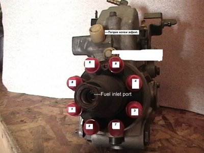

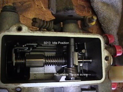

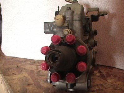

The upper White plastic cap is the torque adjustment, perhaps the lock nut is loose there. The lower White plastic cap, I forget what it is, but pry the top one off, they pry off hard and see why it's leaking. Both caps are just on there so they are not messed with. Those caps are NOT seals.
Looking at the 3rd pic, you will see the torque screw inside the IP, the pic is with the solenoid cover off.

That is as posted. Nothing more than the torque screw. All it does is press on a lever in the top of the pump. Even if it was sucking air that area is well after any fuel in the pump and at that point the fuel is refered to as return fuel to the tanks. It will not cause the engine to not start or run. My best guess is what the "expert is seeing is a problem sucking because of other internal stuck valves like maybe the pilot valve?? I'm no expert but I can guess like anyone else on this issue. Might be a good reason to purchase a rebuilt injection pump anyway. Sitting all those years can cause several areas to plug up with varnish.
