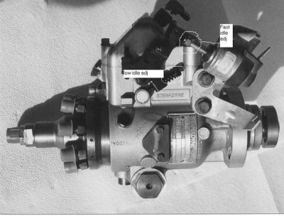

OK i got good news, The IP is toast he said it is sucking air at the plastic piece that faces the motor! I guess its made as a relief but the seal is toast and now its sucking air, Said it most likely happened before it was parked.. Everything else seems ok!! so ill order one tomorrow most likely and hope to have it purring next week!
342
I would sure like to know where that plastic piece is that is leaking/sucking air in.
There is no seal that I know of that is plastic. The only seal externally is an O'ring on the drive shaft, and that will leak due to fuel pressure and leak into the valley pan if it has the relief hole. There is an O'ring on the fuel line in fitting, easily replaced.

There is 2 plastic caps on the side where the lines come out. Right above them. Said top one is sucking air.
