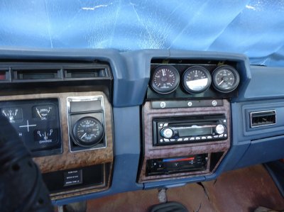

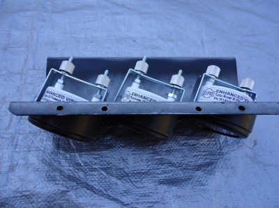

You could put them above the radio.

those ideas looks awesome! i really like the idea above the radio! and i was thinking on boost, pyro, tranny and either engine temp or oil pressure. any other guages i should really look into? i actually got a 311 tool piece set since i get 50% off student dis count. but i think i just got a job at kubota dealership! so the build should come together must faster. im so pumped!
