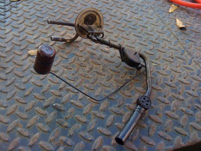

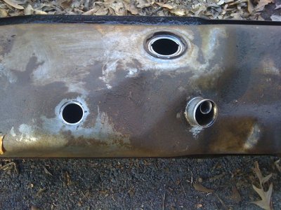

ok, so I got the front tank out today.
I can't see any damage as to why it was leaking, other than the big oring under the sending unit is pretty crusty and old.
the sending unit has the ford logo and E3TF-9275-AC
there wasn't a shower head on the pick up and I siphoned ALL the fuel outa the tank and noth is rolling around inside that I can hear...
HERE'S THE PICS
