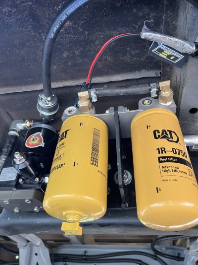

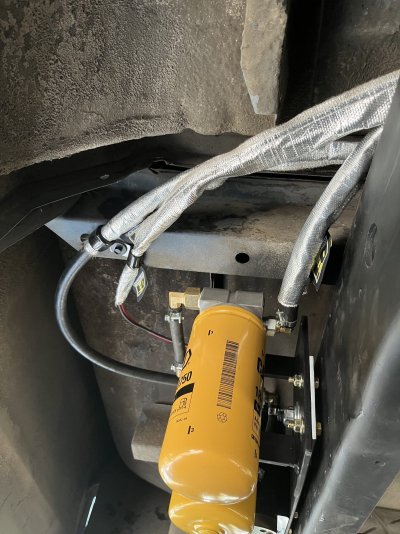

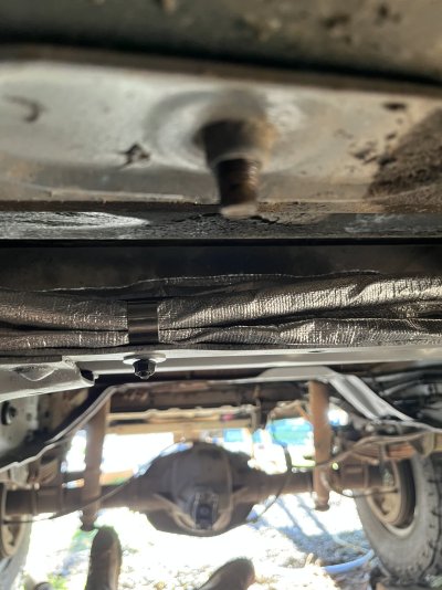

Simultaneously I was running the wires and fuel lines to/from the pump.
due to the pump being on the passenger side I had to run the lines over the exhaust on the cab cross member. I used some heat shielding stuff on the lines and wires to protect them. I’m planning on adding a shield to the exhaust pipe as well when I get to that step.
I finished up the pump as well, installing the inlet filter and the hoses to connect the two filters. Things are starting to really take shape and I really like how it is turning out.
