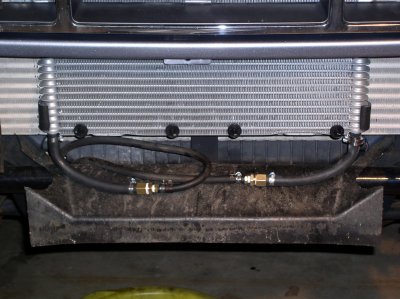

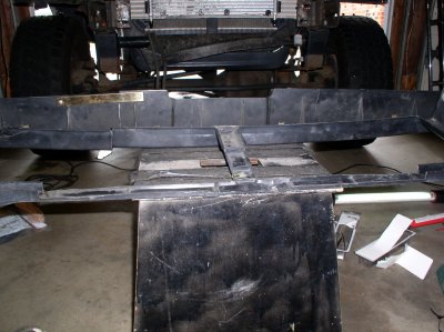

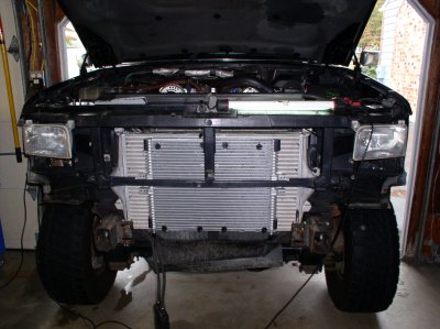

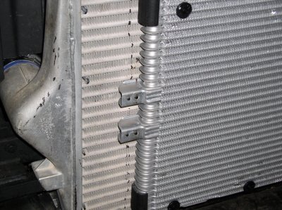

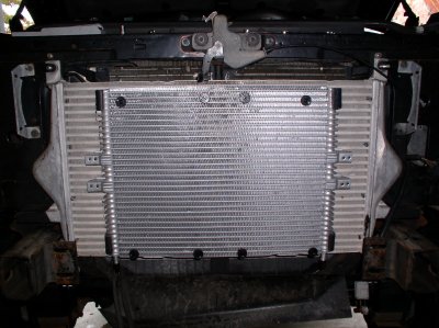

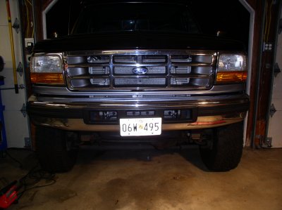

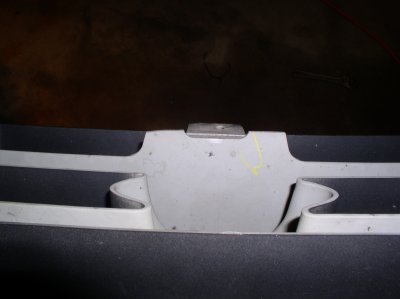

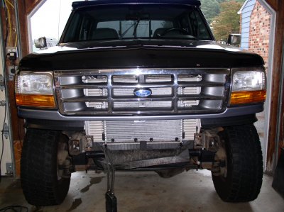

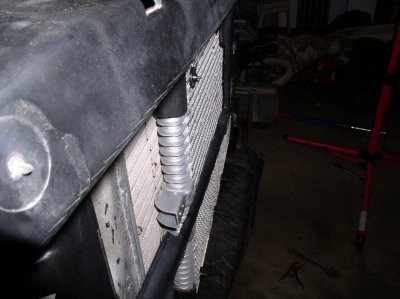

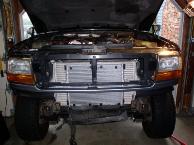

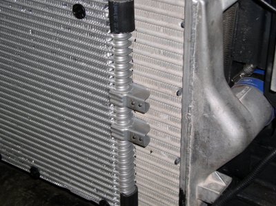

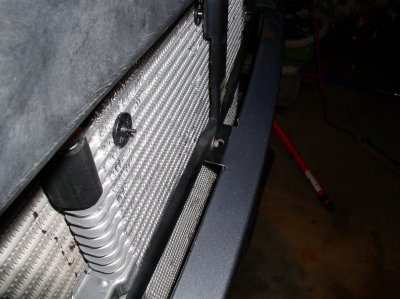

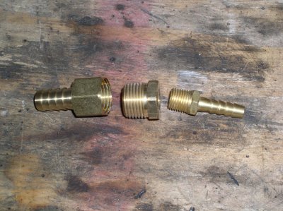

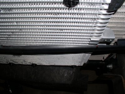

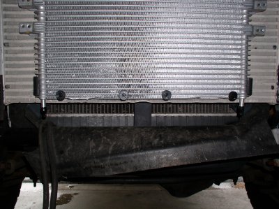

Well, my big projects for the summer are done. Did the Tranny mod today. Went pretty well. I decided to cut the brackets off to lessen the amount of room needed to mount because I was already limited on space. I used 8 radiator zip ties & the thing WILL NOT budge. Spaced it forward off the IC using the little foam pads that come with the zip ties & I cut some pieces of heater hose to wrap around the corners just to be safe. Didn't have to cut to much off the back of the header panel either. It got a little thin out toward the ends of the cooler but everything is still sturdy when put back together. Took it for a spin & the temp gauge didn't even move. Got back & added a quart & a half. We're pulling the 5'er this weekend so I'll get a better read on how well this mod works on the older trucks. Worked wonders on my 03 some I'm expecting good results!;Sweet Only down side was I had to tear the whole front off the truck again to do this.......
Pics for ya...

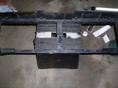

And the rest of em. Had to cut a little off the back of the grill because it was so close. Thats what the weird pic is.

That looks nice. I've seen this done on earlier SD's, always wondered if it would fit on an OBS. Looks like a snug fit with that intercooler. Good job!
