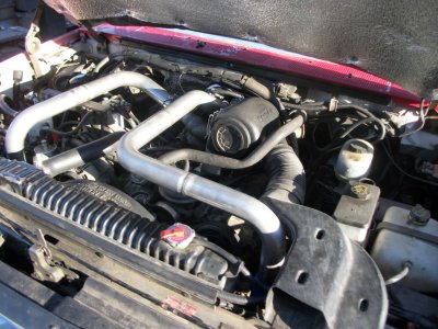

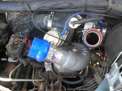

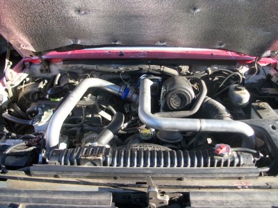

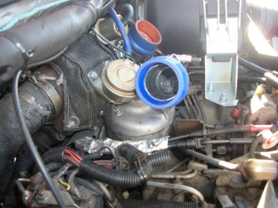

tonight on log truck..........it's the final installation of the FMIC.;Sweet
so the pressure chamber gets tapped and the boost fitting inserted.
then it's set onto the intake,after tipping the compressor upwards to clear.
attachment.php
attachment.php
next i held the pipes up and marked them with a straight edge,took them up to the local welding shop,and when complete simply installed them for the final results.
attachment.php
attachment.php
sounds easy anyway right lol? it's because it is actually.i tossed it together today after work.so i'v still got to mount up the trans cooler and then turn up the fuel in the ip again (max it out now) but...... log truck is now intercooled.;Really
until the next episode,i hope you enjoyed this one here on channel 444.;Sweet

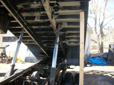

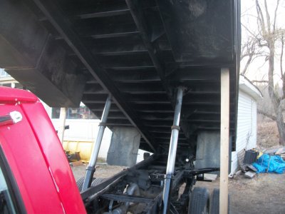

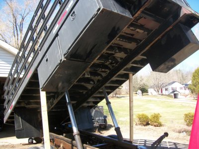

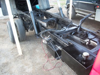

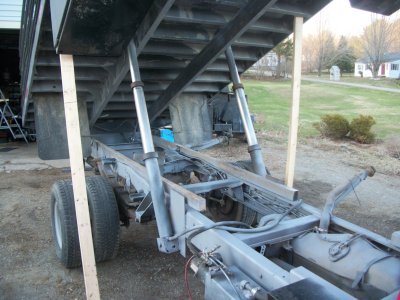

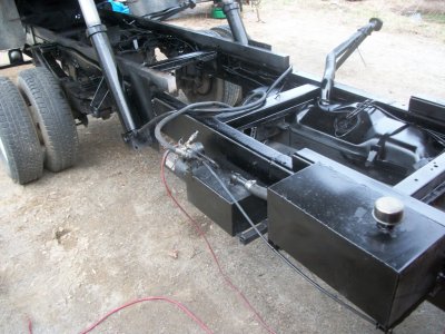

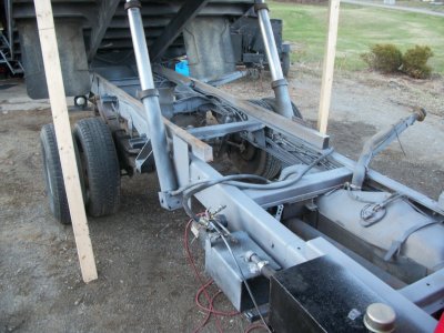

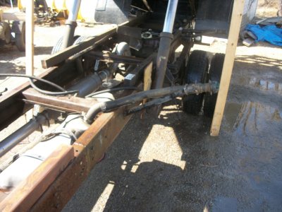

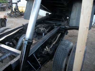

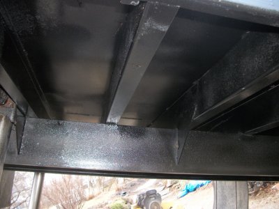

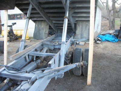

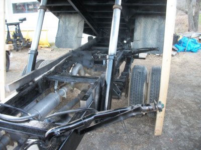

log truck is back.in this episode,it's time to get this clean 2wd painted up so she remains clean.so it all began with pressure washing off all the loose dirt,followed by a soaking of por-15's marine clean (cleaner degreaser) followed by a rinse and then a soaking of metal prep (prep and ready) then after 15 mins,another rinse then finally a coat of primer over any rusted surfaces once it was dry.
stay tuned as log trucks' underbelly gets a few coats of black valspar tractor & implement enamel.;Sweet

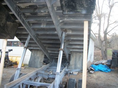

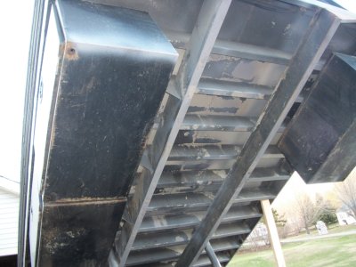

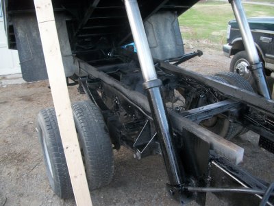

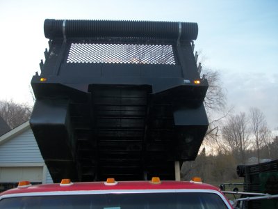

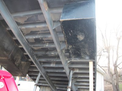

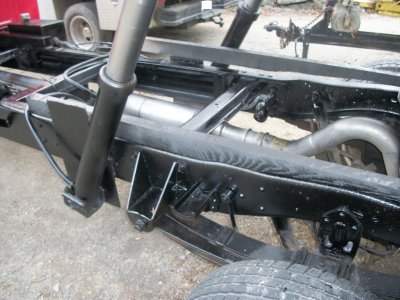

All this power, and still not enough traction... You got her stuck just looking at wet grass yet? LOL
Btw those drop towers for the bottom of the lift cylinders look kinda sketchy, may wanna take it to the local welding shop and have them take a look at them and recommend some improvements. At the very least run a few bolts thru their plates and into the frame rails... Has the frame on this thing been stretched?
You are putting good amount of work in her tho, hope she pays it off quick.

i know it.im still a bit skeptical as to how (or if) a 2wd is going to be (dang that e-brake dilemma for a clean,safe 4wd convert.)
they don't look the best up towards the top either.i'll have both ends beefed up a bit,and the local welding shop also needs to rig me up a safety arm i can swing down while working on the underside.
yes.this was the 161" WB that has been extended out to 197" WB.she sure doesn't turn on a dime lol.:rotflmao

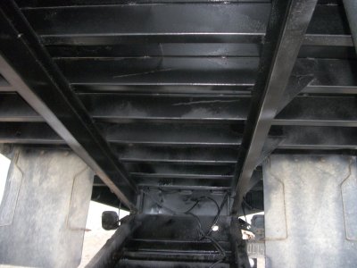

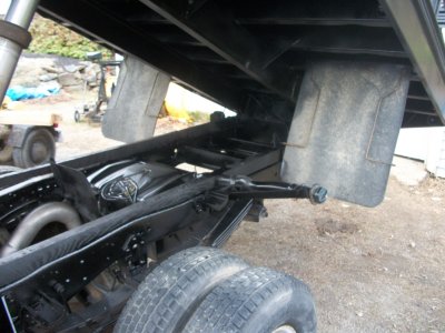

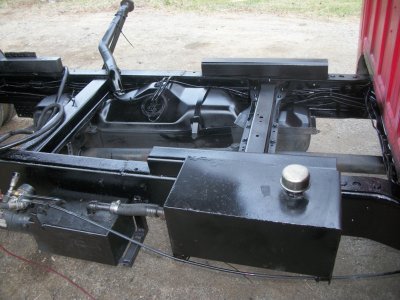

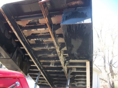

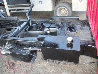

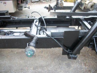

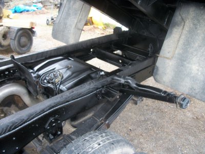

coat number one applied this morning before work.valspar tractor & implement enamel.gloss black.half gallon so far.2 spray gun tank fulls for a decent thin coat.keep it right here on channel 444 for her second coat soon.as always,i hope your enjoying this episode of log truck.;Sweet

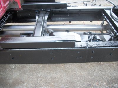

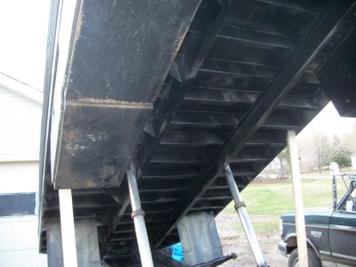

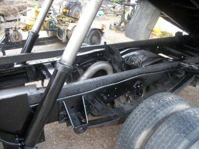

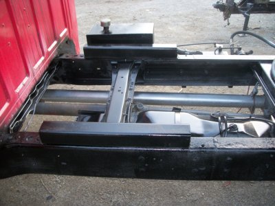

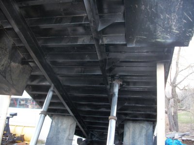

tonight on log truck.........log trucks gets her second and final rear underbelly & frame coat for a total of 1 gallon of valspar tractor enamel.
that should keep this pavement princes clean for many,many years to come.;Sweet
