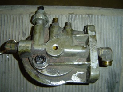

hey Ron if you want something cheap and on the quick you can throw a gp in your filter

Filter changed and filled it with Stanadyne. All is good, no pump issues and I was able to hit 9 pounds of boost with a scorched bearing.:eek:
Next on the chit list.....
Turbo rebuild.
I think I might try that Aric, thanks.;Sweet

since I couldn't make a seat for the gp to seat against I used a pipe dope and then JB weld to keep it from leaking. even if you don't need it all the time its nice to have some heat in the filter in case something crazy happens like you forget to purge
