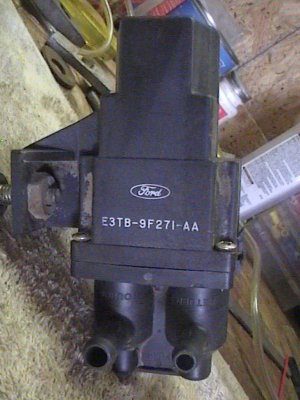

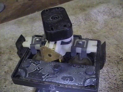

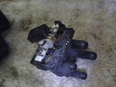

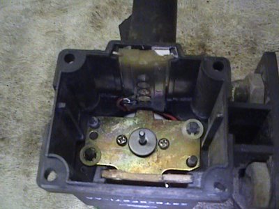

Personally I would never pay that. Below is what I used to replace mine. It also fits my 90 truck, as far as I know it will replace any two tank selector valve.
Also if you suspect debris in the selector you can tear it apart and clean it out with little trouble. Just drill out the four rivets with care, use #8 sheet metal screws to assemble.
