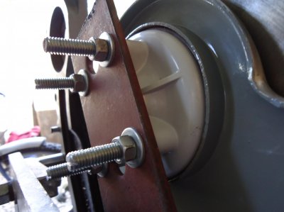

Only the Ford seal/wear ring combo are installed with the plate on the engine. A stock seal is to be installed in the plate from the engine side with the plate off. You will need some sort of seal protector like a soda cup to install the seal and plate as a unit. If you go that route you will have to remove the plate and clean all the RTV you just applied. I drilled the install tool that came with the seal and sleeve and pressed it on using allthread. It worked but still tried to **** on me. I didn't have a lot of hope for it but the seal didn't leak. One of the corners on the plate to oil pan did leak, so I have been down this road a few times.
Rt click on pic and select view image for a smaller size.
Just saw your last post. The seal in the Ford kit will be too big without the supplied sleeve. I think a Speedy Sleeve is thin enough to use with a stock size seal. The Ford sleeve is pretty thick. Since I hate leaks i pulled my plate and installed a SKF seal that fits the OEM wear sleeve, since I had the sleeve on and didn't want to try and remove it.

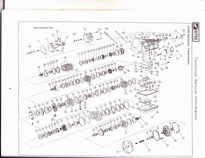

The seal I was referring to is #37, if it's the original seal, I would replace it with the new Teflon seal.

Well I got the ******* in finally. Ended up getting threaded rods to help push it in straight. Worked well.
