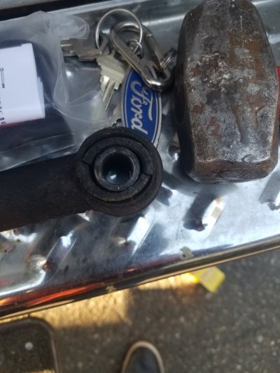

Always noticed youtube videos of guys driving and the steering wheel is off centered, so I started replacing suspension bushing, leaf springs first it helped a little then I replaced my track bar bushing and now my steering wheel is centered.
