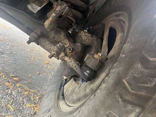

Might have been expensive and taken 2 weeks but it is nice having stuff done without having to actually do it
