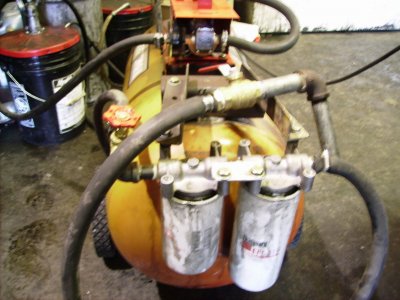

so basically all I need to do is bring a few gallons home, filter it down, mix with diesel and run it. Keep uping the wmo in the ratio till i get "undesireable" results and then back it off to the last ratio. Im thinking of getting a fuel filter assembly off a 6 liter (as I can likely find one at the shop for free) and use that to filter till I can afford the cat filter set up. At least that will get me up and running. How often do you change out your fuel filters running 50% and 100% wmo?
here is another option getting 2 filter heads from fleet guard u can probably get them from any big truck dealership the dealer ship that u work at might be able to get fleet gaurd stuff
any way the filters that im using are 10 and 2 micron that are cat filters the heads are really cheep to so if anybody wants part numbers PM me and ill gladly give them to yall
