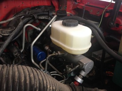

Tim-
he's not a mechanic. Keep it uncomplicated.
you too will find out when you move out of the area, ******** like me are not easy to find. Tom can't find anyone competent to do his ZF5 conversion in MO.

a hydro is a power steering brake booster stolen from a F450 of 88-94 vintage and dropped in where a vac booster system was at. see below for pic.
