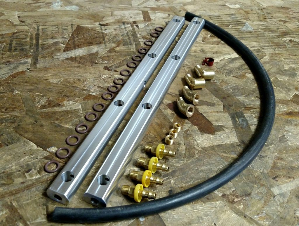

Once you have fixed your injector issue (torque it down), you could kill 2 birds with one stone by installing R&D IDI fuel return rails. They are billet aluminum (not gonna melt) and once properly installed they minimize air intrusion.
I got some for free with a couple parts IDIs and I like em'. Haven't used them on a DD yet though.

I'll look into the rails. I do have a turbo, so would the heat be a concern with aluminum? I don't think so, but it's worth asking.

I've been interested in those rails also. Seems like they would eliminate some problems but I wonder if they would also hide some problems?
How would you know if o-rings are leaking? Or if, like the OP, you had a loose injector spewing heat out?

If your copper washer was leaking you would have carbon on the injector threads. You’ve got heat traveling up the fuel feed of your injector. Aluminum rails may not melt like plastic caps but you’re not fixing the problem. It’s only one cap melting? There’s a problem with that injector.

I haven't heard of issues with rails and a turbo. Then again, anything is possible. This thread has some info on aftermarket fuel return setups... Might be a worthwhile read:
Seems like people run turbos and rails without issues.
My only concern would be running the rear rubber line under the turbo with all the heat. Those rails can be set up to have the rear hose connecting the two rails rout through the middle next to the intake if you are worried...
