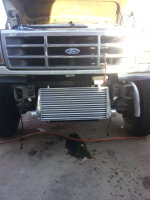

Well a little more progress was made. Things went slow as a lot of my buddies tools and such he left at work. I am saddened that my darn new brand new AC Condenser now sports a pinhole :rolleyes: but I guess I needed another project to fix. :eek:
Intercooler mounted. It's a little lower than some might like, but I'm pleased. This is essentially a pavement princess so I'm not that worried. I thought I had a pic with the bumper on it, it hangs down roughly 3-4" below the bumper. What I like is that it doesn't interfere with the AC Condenser or the radiator air flow.

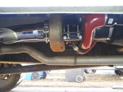

Thats one short Tail Pipe! I'm hoping it makes this thing sound like a Jet!! :love:
I had a slight worry about a rock flung from the tires might somehow find it's way up thru that tail pipe into the turbine wheel. You can't see it in the pic, but inside that pipe is a layer of expanded metal that should act like a grate to protect the wheel some.
