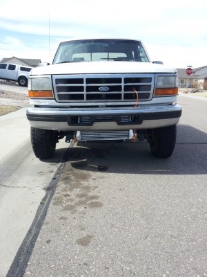

Took a pic of the intercooler position today. The boots are not going to be positioned as you see in the pic, nor will the grocery bags be in there to protect it. LOL
For giggles I think I'm going to make a cover out of expanded metal that goes in front of the cooler to further protect it from rocks getting thrown from other vehicles.

How will you make the protector? I guess I mean how will it attach and not inhibit flow over it?

it'll just be an expanded metal front cover I'll form to fit. no big deal. It wont make that big of a difference in airflow
