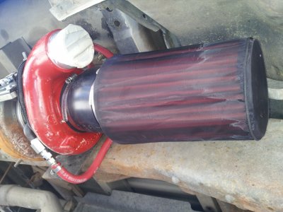

$4.50 Sewer Hose clamp and the Air Filter is in place.
Don't know how much more progress I"ll make today on it. I might yet get out there and spray can the Y PIpe and prepare it for Header Wrap. I've gotta go to Ft Collins later and get 30 gallons of waste trans fluid from a buddy to make my next batch of fuel. Why is it days off always get filled up with crap to do? :rotflmao

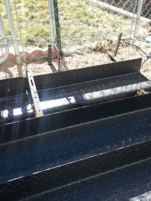

These are the running boards going on after this is all said and done. I'm thinking I can make a skid plate of sorts that goes from the frame to these running boards that will protect teh turbo and filter from road spray and I'll be fine. These running boards hang down several inches lower than the turbo sits so side spray from the tires and such should deflect alot of it
I will have to be cognizant of where my air cleaner is located as I back our boat in the water though! :rotflmao Our boat ramp is never going to cause me issue, but if we did take the boat off our lake I'll certainly have to think about it some
