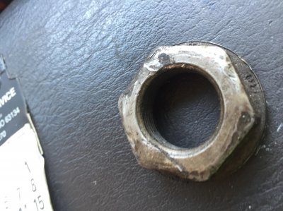

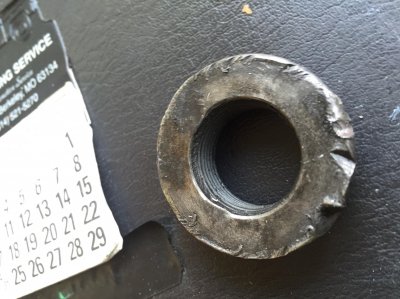

Update: I was driving down the road today and heard a pop, I wasn't sure what it was, and the truck stopped shaking and vibrating. I drove back by and looked for any parts that might've fell out. I found a nut, that kinda looks like a spindle nut, and I'm not sure if it came from the truck or not. Is there anyway to post pictures to the thread?

There's the pictures of what I think popped out of the truck.

2 wheel drive? Probably off the output yoke on the trans. Doesn't quite look like a balljoint nut.
junk
May 25, 2006
1,773
63
Paullina, IA
I'm thinking nut off a yoke if it came off your truck. If it is a yoke nut that came off I'm guessing something will grenade in short order.
