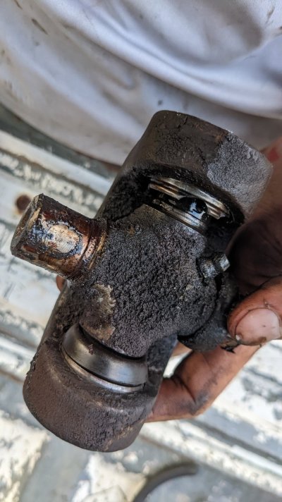

Got home from the parts store. It was a horrible drive back.
Looksy what I found when I got underneath! Talk about close! Hope the driveshaft ain't damaged.

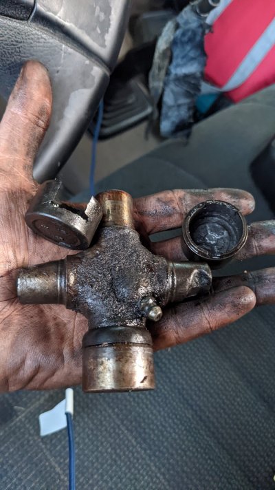

305k+ miles. Finally came to an end.
RIP

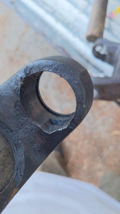

Well Nero, the 1.188 u joint (biggest they have) is too loose. I'm wondering if the yoke is bad? It fits snug on the driveshaft.

The 1.188 is the size that fit mine. Mine were super tight and difficult to press in/out. I think previous owners used the “big hammer” method and deformed the yoke on mine.

With how one u joint cap was worn all the way through, could have some damage to it causing the hole to oblong.

I used the press to get them on the driveshaft. On the tail yoke to the tcase, it is very loose per my video. I bought a third 1.063 u joint just in case and to compare. It's definitely smaller by 1/8th of an inch. It's just the tcase yoke that's super loose.

The caps off the old U joint didn't seem loose in the yoke in the first video you posted. Get a pair of calipers and measure what's left of the old caps, the new caps, and the yoke bore. Get some numbers.

I finished last night at 3 am. I had the attitude of it works it works. Clips hold the u joint on the transfer case yoke. Everything was pressed into place on the driveshaft. Only issue was the yoke, which I will need to order a new one eventually. The old caps were very snug, not sure why they are not now but like I said, in the driveshaft they fit very tight.
The truck drives amazingly smooth now.
That last u joint cracks me up how bad it was. Goodness!
