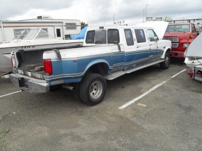

If you don't extend the frame, will the rear portion of the "new" cab hit the kick-up in the frame? Will you have to cut out the floor and let the frame come up through? Or use a body lift?
13,320
3,885
as i looked at this with the bed off last week, the mounting points for the new cab only raises 1" where the back of the new cab mounts will be.
it will not extend where there is a substansial increase in elevation on the frame. will be using an aftermarket body mount. not much fab work required.
again this is all theroretical, i will have detailed pics when we get on this.
i may have to cut up one of the extra beds i have to make the wheel well look stock ish.
i want it to look as clean as it can

So, the time has come to start this project.
Rear portion of the add on is braced, doors welded together, and I'm ready to start choppin!!

A lot of progress.
we got the truck stripped cut, and added on the extra CC doors.
it went like clock work! i think we drank more than we worked!
all 6 doors open and close with factory gap. structure is solid.
i was supposed to do rear body mounts tonight, but im pretty drunk.
ill get up at the ass crack of dawn and get them done before the guys show up in the morning @ 9am.
body lines look killer.
had to cut the entire floor out due to the frame raise in elevation. to the naked eye, it looked ok, but the real world smacked us in the face.
only had 2 others show up today. tomorrow will be 5 but more of a BBQ and get the roof tach'd together.
these guys are confident we can get the roof done without it looking like ****.
we will see what tomorrow brings.

Rear body mounts are done, I still need to piece the floor together.
I nex to figure out where the filler neck is gonna go, but Roof is in place. Went together about as good as it could
It's got a weld about every 1", I'll be finish welding this week.
all in all, it was a great weekend with my brothers!

Looks great! I would make sure I had a trap door over that fuel sender! Keep bringing the pics!
13,320
3,885
im even thinking about a door to acess the FSV too. would make it much easier to get to the top fuel lines.
i need to replace it neways!
still baffeled on what to do to the fuel fill, thought maybe i should run it next to the rear fill tank, since i am going to cut the bed down to 5 feet.
