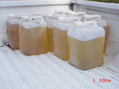

wow Jim that is some overkill you got going there lol. I let my oil settle for at least 24hrs lol pump through some whole house filters down to 1 micron and let sit in one of three 50 gallon drums until i need to use it. I wouldn't worry about pumping it straight into the tank after 24 hours heated and filtered. To each his own though of course.
to the OP if your oil look translucent in a jug then it's probably pretty decent oil. Still filter to 5 micron or less through a sock filter is fine, and pretty cheap. You can pour just avoid pouring the bottom couple inches and be careful not to stir it up when pouring. Oh and once everything is settled make sure to check the bottom of the jug for collected water. Be careful not to let that out of the jug when you pour. Guys go way overboard worrying about water in the oil. Thinking things like 300 parts per million is gonna rust out your internals and thats absolute hogwash. Just make sure you don't let any bulk water into your tank and you're fine.

I have seen water issues (water in fuel light) with some oil I have used. but I wait a week or 2 before i pump of the top part of the jugs and now I don't see any problems......

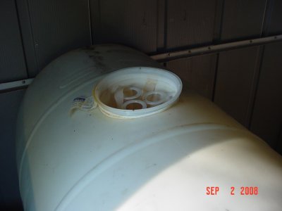

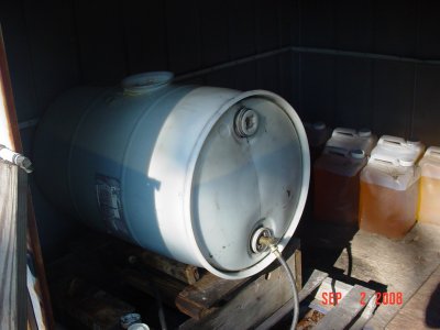

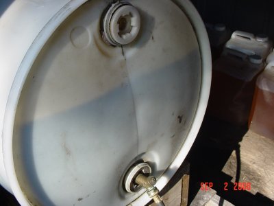

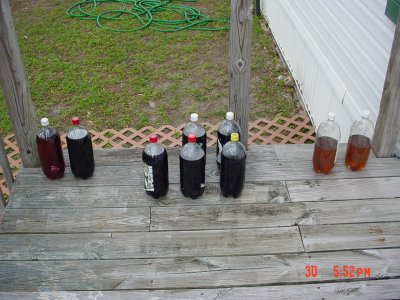

Here are some of my pictures, I have changed things a little......
you are my hero...I NEVER thought about laying the plastic barrels on their side....I have a available free supply of these but often forget when I need metal ones and always seem to run out...
You like that, I've moved it and made some changes.... Just got my camera working I'll take some new pictures. it was easy to cut the hole with a sharp razor knife, the bag fits in tight and works well. The bung is not right on the bottom so it helps to settle it even more.....:sly
