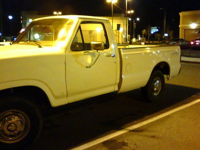

FWIW I don't know if they bolt up or not, but I saw an '87-'91 bed on a '70's pickup frame, and I also saw a SuperDuty bed on an '80-'86 truck cookoo
No pics of the '70's truck, but I snapped a couple pictures of the other one...

They will bolt up. My 86 (the one in the picture) had a 97 bed on it. Molly has a 97 bed also. IT WORKS
