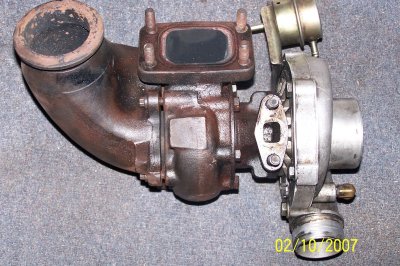

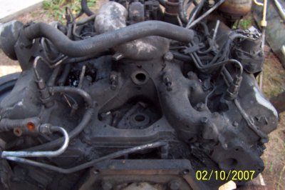

Here is the jist of it all. The turbo engine is home- less the turbo:mad: which was sold before I purchased the engine, even though I did see it on the engine.
So I have some pictures of the rear of the engine, and the bottom of my turbo. I would like to know what part/s and or brackets and bolts I need to mount this turbo up correctly and if anyone here has them?
Well any suggestions, part #'s etc would be appreciated. I am still looking to get a rebuild kit for the turbo.
Thus far, I have found from http://www.atsdiesel.com/ the upgraded wastegated exhaust housing for $283.50.
They have the 3" downpipe as well and it is $71.56 and it may fit my housing they are looking into it, and will get back to me.

Looks like the big pieces your missing is the mounting bracket, which plugs the intake, and the turbo drain and valley pan grommet. The piping of course, and the air filter, but you can build one of those yourself easy enough.

Mel,
You wouldnt have a picture incase I find one locally at a yard kicking around?
These guys just rip parts off n some times small bits are left behind...so other than Grommets which I feel are soft parts...like gaskets etc...what hardware just the Bracket I guess eh?
As for intake plumbing, I had planned on finding a stock Turbo air box and then running a 3" or 4" pipe into the box and out the fender to a snorkel intake setup.
As well I have to clock the turbo and redo the hat on the intake to accept intercooler plumbing....again those are planned out.
Thanks for the info,

Can't help you with the ATS pics myself, but several members here have had theirs apart. Hopefully they will chime in.
