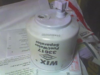

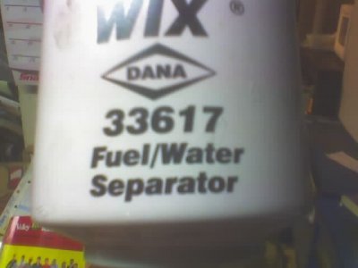

Is it because it will rust it? Water has the same compressablity as diesel fuel, none. How does it hurt the pump? Good call on the filter towcat, does that filter have a way to drain the water out?
you bet. see the knob?
