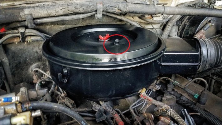

That was a long post and I apologize, my engineering mind is going down a rabbit hole getting back into thinking of a methanol injection system. This is exactly what I was planning on doing some 2-3 years ago before I sold my old truck and got this new one.
I attached an image of what I was thinking. Is this the port you were going to plumb the sprayer into? Ideally, if you can clock this to the back and weld a tab onto the lid that aligns to something on the filter housing to act as a sort of key, then you could reliably control your sprayer characteristics.

@ISPKI: love the posts! Thanks for the in depth analysis. Yes, I agree that is should be centered. There is so much vacuum suction at the intake, I’m not sure that favoring the rear cylinders would be effective, also, I don’t know if it’s worth isolating the individual piston temps to figure it out. I’ll probably just try pointing the sprayer right in the center.
