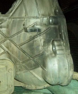

In the FWIW dept, you can buy from Ford for about $1300 and still have a weak link {the DMFW} or go with a LUK unit for half the $ and better performance, able to take more abuse {read work}.
I used the LUK unit in my '90 IDI and absolutly hammered that thing for close to 200 k mi ;Sweet
I also have a single mass South Bend in my PSD that see's it's share of abuse between my work environment, trailers AND hooking to 40k lb sleds :Sly where I come out of the hole at 2500 turns just to get the sled moving before dropping the hammer, so I don't see any evidence to support your "weaker" theory :D
Here's what happens when a dual mass decides to grenade...... 1 before repair and 2 after...
