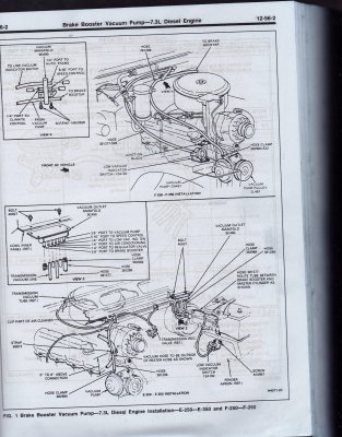

Holding your finger over the end of the hose it should almost suck the blood out of your finger. If you have the tomato can (vacuum reservoir) on the drivers side fender it may have rusted a hole in it, if so, you loose all vacuum, check it out.

oldbull thanks for the pictures. mine is a '93 and does not look like that. I think someone has messed with it in the past. I do not have a vacuum reserve can at all. also i do not have a vacuum line going to the transmission, I think that is only for the C6 right? I have the E4OD. My vacuum pump is on top of the engine on the drivers side and lastly the manifold is on the drivers side fender not on the firewall. I think while I am doing all this I will try and replace the old brittle vacuum lines too.
