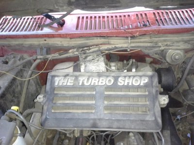

I have a 1984 f250 6.9 idi with a turbo kit.. looking to try to figure out what kit it is... any idea??

Welcome to the forum. I have seen this type before but can't recall what it is. I do recall its an older non wastegated turbo from around the mid 83 to 85 years I think. Typ4 aka Russ will know and tell you where to find parts or he can rebuild it for you. Thats what he's known for around this forum and around the world too. Must be nice to be world known and famous too.
