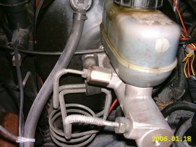

Here are the pics from the brass adapter on the MC.
For everyone, I'm on the process to swap from vacuum to hydrobooster on my brakes and Towcat and the info some of you **** care to write up are helping my go through it.
Will this on fit or I need to replace it for another one?
I hapen to have the reservoir with the two drain plugs maybe PO put it there.

you have the pump res already ;Sweet
I will measure the mounting stud later on in the morning when I get out to the shop. i am stuck playing dispatch right now. :puke:
1,442
ez-
the master cylinder mounting studs are 3.75" outside to outside. measure yours where the master mounts onto the booster. that spec must be there or you will need to get a new F450 master.
