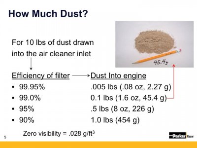

Marmot: Clean air is important but changing filters at 9K, without justification such as an extremely dirty environment or a restriction gauge indicator, is a big waste of your money and absolutely no benefit to your engine. If you read the attached article, there is a great statistic from Jon Wake... most of the dirt that makes it past your filter into the engine gets there in the first 10 percent of the life of the filter. Filter efficiency improves with use and that first 10 percent of use is when the efficient improves by 1-3 percent. If you change filters too often, then it never gets to that point where efficient has improved. Bottom line a NEW filter filters WORSE than a used one. There is no harmful effect if the engine wants a little more potential airflow. Most engines live that way all their lives because few intake system deliver every CFM the engine would like. Clean is most important. More airflow is only important to power production.
Filter restriction can effect power but the general statistic is that most intake systems are built with 20-40 percent more flow capacity than the engine needs to make its rated maximum power. When the filter gets ordinarily dirty, you will not notice it in daily driving but you might notice a drop in power on the dyno. When you get significantly into the dirty area, you will notice the power drop more and more. Fuel economy is effected on diesels by filter restriction, more with our style of engine than the modern electronic diesels, so that is a reason to be more vigilant. In that case, a restriction gauge is your friend as most tests have shown if you change the filter at a lower restriction, you err on the side of economy. Most engine require the filter to be changed at around 20" of water (max intake restriction). If you change it at 15", you err on the side of economy. Exactly where you change it is somewhat engine dependent and variable. Some engines start with some restriction even with a new filter so if that was the case, you'd extend that out a little. The answer is simple, you test with a fresh filter and then change when the gauge reads about 10 " more (give or take).
To hammer home the impact of a 1-3 percent improvement in efficiency as the filter loads up, I'll post this again:
attachment.php
