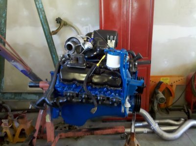

just gonna give everyone heads up .getting ARP heads bolts ordered! so gonna finish the lower gaskets tonight and hope to have engine painted by the weekend if parts get here.Ive been moving really slow lately

I think it's a beautiful engine. That being said, I'm partial to IH red since I've had my hands in more IH tractors than any man should acknowledge.
Great write up tho!

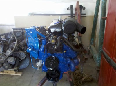

I read you'll be using the c-6 and I see the Banks system. I too run both. FYI upon install you can have all the turbo components together which ensures a leak free system (except the crossover). The only flaw in Banks design to me is the dipstick tube routing. For ease of head/engine removal, I cut the dipstick tube about 4" up from where it goes into the trans and on install I sleeve it for reassembly. This mod makes it possible to install the tube after the engine is mated to the trans. The only other thing I'd suggest when putting the engine back in is remove the wiper motor because it may interfere with the turbo when your guiding the engine into the bay.
This pic was right before it went back home.

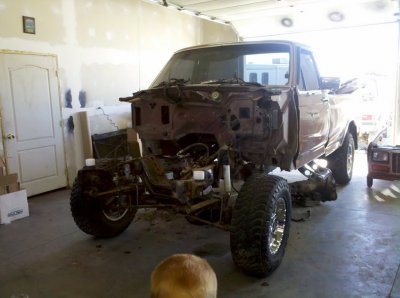

thanks for the in put!;Sweet anyway were taking the front clip off and hoping to put the engine and transmission in at the same time . We also put in a 2" body lift in so we would have extra clearance . Im going to use the wiper motor off the 89 ford truck so Ill have her all stripped out Im gona paint the fire wall. I like the paint on the motor looks great ;Sweet thanks again have a good one

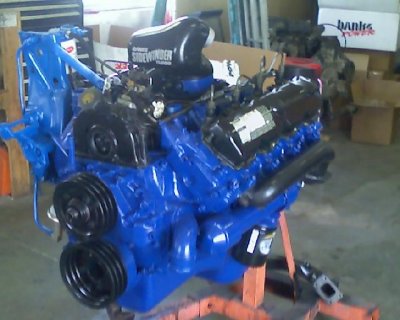

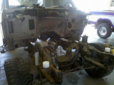

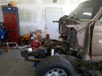

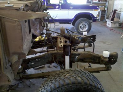

well its been awhile got a little more done today I got the turbo on and all the sendig units in place . also got the front clip off and getting ready to paint the fire wall .

I'm liking your choice of color!
(mine wasn't detailed as well though)
Thanks I love the old ford blue and the black it should be very clean looking when Im done ! I can till ya this much I cant wait to be able to drive this baby!
