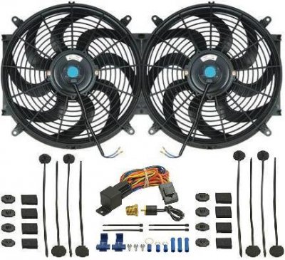

got my new electric fans yesterday and injectors and vally pan

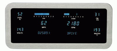

the gauge cluster it self was $625.00 tach adapter was $105 if you wanted the gear display to work you have to have a gear indicator kit that was like $175.00 .Aftermarket cruise control was like $250.00 I spent like 1200.00 bucks for everything
