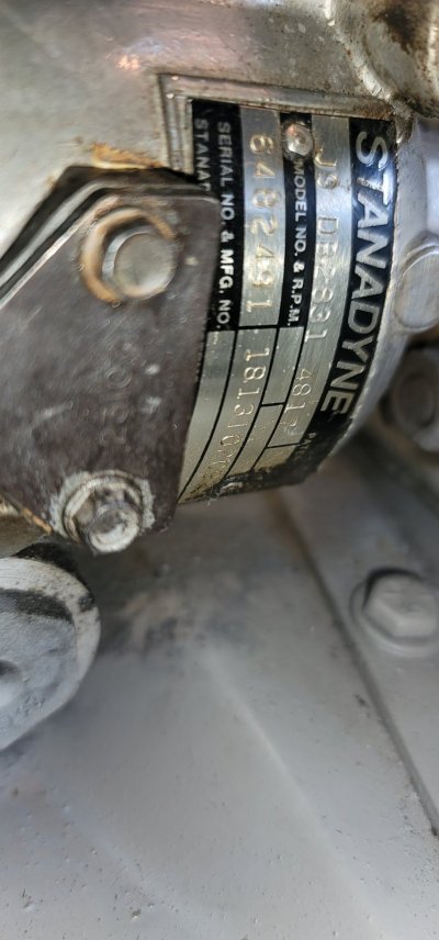

I went to turn up my IP screw a flat or 2 this past weekend and I was only able to turn it 1 1/2 flats before it stopped. This worries me that a previous owner has turned it up too much so I would like to put it back to the stock setting but I don't know where that is. The truck had zero black smoke and is N/A. How many flats from maxed is the stock setting?

Should have more adjustment left than that on an na calibrated pump. What numbers are on the side of the pump?
