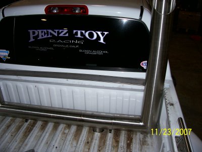

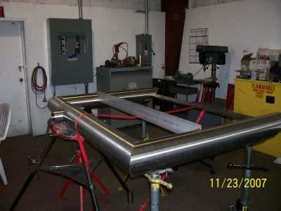

Personally, I didn't like all the fittings, clamps, nuts & bolts, etc. so I just made my own from some polished 6" stainless and TIG welded everything. Since I already had 4" stainless it was easy to make the transitition up into the bed. I'll post a pic or two if you're interested in doing your own.

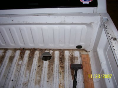

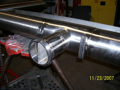

here you go...
just a few pics to get the general ideas goin'.
If you need more details just ask.

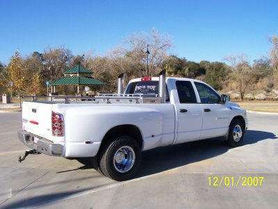

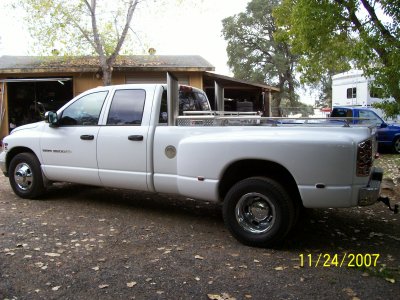

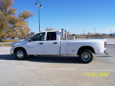

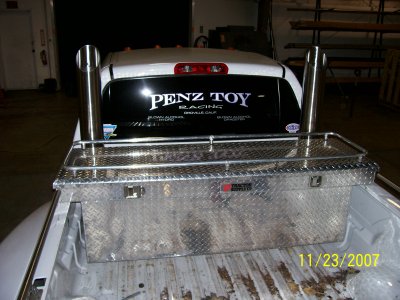

oh yea, the finished product
took three shots to see how they look in the daylight...

Thats a pretty nice set up you got there How long did that take you to make and what gaige aluminum did you use?
cdennyb
Oct 23, 2005
83
Northern California
How long?
Well, I started about noon on a Friday and rolled out to lock up all done and ready to roll by 7:30 that night. So... about 7-8 hrs.
And...
IT ISN'T ALUMINUM! This bad ass set of miter cut stacks are all 10 ga stainless steel from Turbo to tips.
Glad you like them.:thumbsup:
