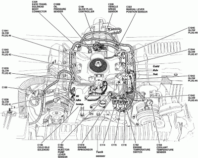

342
To find out if the cold advance is working, turn the key on without starting, press the go pedal to the floor, then see if the Hi cold idle solenoid plunger has advanced on the IP pass side, if it has not, see if the connector is plugged into the temp sensor located by #1 cyl glow plug, There should be 12VDC to the Hi cold idle solenoid and on the cold advance solenoid on the IP drivers side. The plunger on the Hi cold idle solenoid can be adjusted with a 1/4" wrench to set the hi idle at around 900 RPM.
