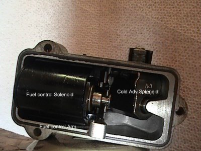

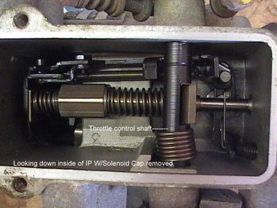

342
The cold advance solenoid is energized for the length of time that the Hi idle solenoid is energized, the Hi idle solenoid is energized until the coolant in the pass side head reaches 120*, never timed it but seemed like about 5 minutes. You could prolly energize it forever.
Edit 2:30AM The cold advance solenoid also controls the internal case pressure along with the fuel inlet pressure regulator on a cold start.
