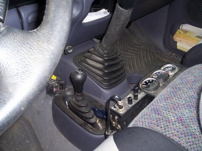

Gauges are a good choice for your truck.....................If I were you I would get the "A" piller pod with 3 holes and do the fuel pressure , tranny temp and in the 3rd hole I would do a combo gauge of exhaust gas temp and boost........also if your stero has a tweeter in the a pod they make a 3 hole pod with tweeter hole .................this is exactly how my truck is set up
I have some gauge pics here of my A piller and also a dash pod that I mounted infront of the center seat
