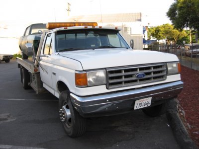

enjoy your stay here, there's much to learn. here's a pic of my '89 waiting for me to take us back out on the road once again.
