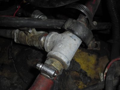

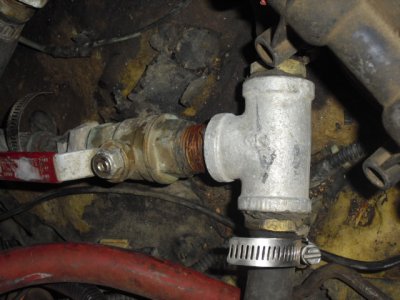

Here are the pics of where I get the hot "coolant" for the tank, with a shut off valve in case of emergency.(Or operator errorcookoo)
The other pic is the plain jane 3 port valve.(for the fuel coming into the engine, have another one just like it on the return line, didn't want to get under the pickup to take a pic)

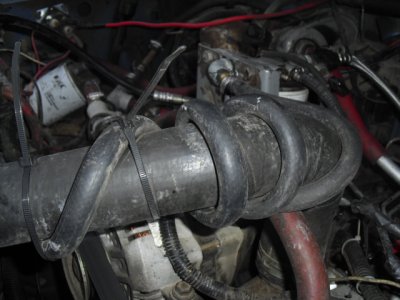

The last pic is the fuel line wrapped around the radiator hose to soak up a little heat.
(Viewer discretion is advised, pretty dirty pics)
