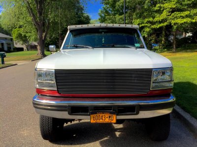

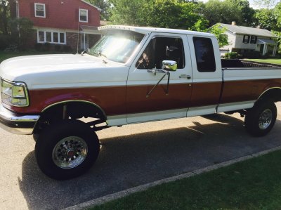

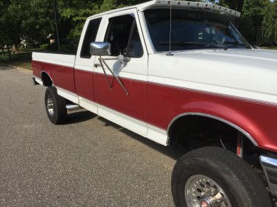

So i purchased a 1993 f250 extended cab xlt 4x4 7.3 idi and im in love with the thing!!!
the truck says it has 110000 on it but who knows these days.. the guy i got it from was not the original owner but the truck is clean.....
