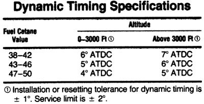

Now the readings... at 1400 RPM I am reading right around a -3.0. I just want to confirm that this IS an ATDC reading, correct? I don't see how it could be advanced to be BTDC as it really isn't very rattly in my opinion. If this is indeed ATDC, I'm not sure I want to screw with it.
I don't have a hydrometer so can't really pinpoint my cetane value unfortunately, but regardless of that it seems I am in the right zone.
anyone have any comments? Should I actually consider backing it off to around 5-6 ATDC like the old manual recommends?

yes the left side of the meter with the - marks is ATDC.
yes you should consider sticking with the book. 3 ATDC is extremely advanced (beyond spec) and engine damage can result. be very careful not to let someone convince you otherwise.
when i timed via the lumy method @ 1400 rpm with my old snap on i had great results with 6 ATDC.

After determining that my timing was at 2.5-3 deg ATDC, I decided that I should try retarding it based upon the factory timing chart and an assumption that fuel these days has a low cetane value. I was shooting for about 6-7 deg ATDC, but ended up with closer to 7.5 or 8 deg ATDC which theoretically is still in spec for me at 3300' elevation. At that timing setting, I noticed a dramatic decrease in turbo lag, but consistently higher cruising EGT's and quite a bit more smoke, especially at start up. Cold starts were not as easy as they could be. I only ran about 5 tanks through, and my trips are varied enough that it is hard to quantify fuel economy but it looks like I was down about 1 MPG.
Fast forward to a month or so ago (yes, I spent Valentine's day evening timing my IDI), I decided that the timing needed to be reviewed again. Since I am working without a hydrometer, I decided to try the other side of the spectrum and shoot for between 4 and 5 deg ATDC. After a handful of little tweaks to the pump, I got the timing settled in somewhere between 4.5 and 4.8 deg ATDC. Since then, I haven't even put a full tank through my rig yet but I have noticed easier cold starts and the engine just seems to be much happier. EGT's are running lower, and as such the turbo isn't boosting nearly as much for normal driving.
