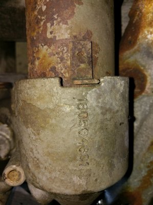

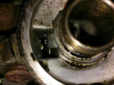

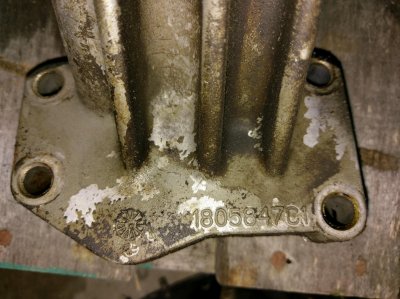

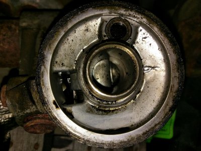

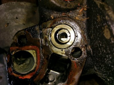

Well i got an email at 5:45PM that they were unable to fine the part requested and they canceled my order. No phone call just an email of cancelation. I looked at the part numbers on the oil cooler i pulled from the 94 and they were the same numbers at the international ones though, not Ford numbers
Just to confirm, those are IH/Navistar Part Numbers. I recognize that format from some of my other IH interests.....
IH/Navistar has used a:
IH-123456-R01
or
1805874-C1
Ford Part Numbers a normally:
E3TZ-6A636-G
So Ford might not be able to find that number, as I am sure they had a "Ford" part number for it also, but I would contact an International dealer and see if the parts counter can find one with that part number....
There are times you will find when you buy a part for any of the Navistar built products that are in a Ford, from a Ford Dealer, when you open the Ford Blue Box, you will find the original International packaging with the part in it. Exact same part you would get from the International parts counter, but with a higher price......... I've bought parts for my 6.0 from the International parts counter, I have a Ford/IH cross reference chart, because the IH part costs a lot less than IH part in a Ford box does.....
