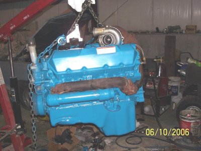

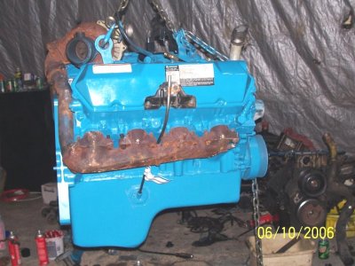

and here is a few pictures

Rich,
the second pic in of your set there shows the exhaust manifold and plumbing back up to the turbo right? (I'm a Cummins guy so you'll need to forgive my ignorance).
Anyway, the bolted connection at the (or near the top) is the bit leaking. He has very little get up and go but has no gauges to measure boost or EGT so I'm only guessing. It is covered with thick black soot and "bleeds" under hard acceleration.
How easy of a fix is that?
Cheers
94f450sd
Oct 12, 2005
6,617
55
somewhere,ma
yup the second picture is showing the ends of the manifolds and the pipes from the manifolds into the turbo.where they bolt to the turbo they have donuts in there.
to replace the donuts is a pain in the ass.you can do it one of three ways.you can pull the turbo,pull the motor or drop the transmission.
