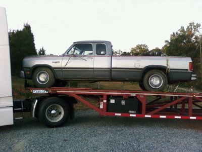

Here is a pict of the doner, it will be here on Monday or Tuesday.

Hey cool!
Thank You for your service to our great country!;Sweet
Those were real trucks, my boss had a 78 I think? he was big 6 something and 200 something and would get on the roof and dance, then climb inside and pop it back out! we would take that thing every where. had glass packs could hear it coming 3 blocks away!

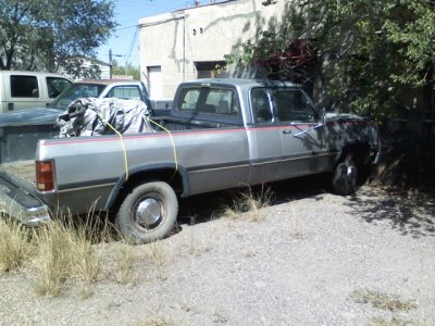

You pretty much said my plan. I am taking a chunk out of the center(ish) part of the 250 frame to get the wheelbase matched. Not sure how much or if any any out from behind the rear wheel. The IC, condencer and radiater are gone. But for 650$ I can't complain. I received the truck last night and I plan on evaluating the wiring before I make any decisions. I'll have to measure body mount locations, but I expect most of them to line up. Stll lots to get, front suspension and transfercase.

A common upgrade the the factory intercooler is a factory intercooler from a '99-03 Ford Super Duty. It takes a little modification to the radiator support. Check JC Whitney for the radiator and if I remember right I've seen a few radiators for sell on eBay too.
Looks like you'll have to either cut-down the stock drive shaft, though from the factory they came with a center carrier bearing. The stocker form the 'Duster may work though. More than likely the front shaft can come from a donor 4x4 Cummins truck.
You may want to do a search. If I remember right, a member here has done a conversion that swapped a Cummins into a 2wd Ramcharger with good results. I remember there was lots of pics and good information that may help you out.
