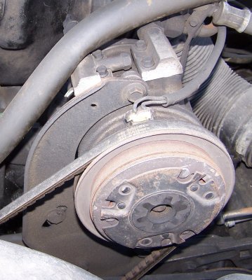

Does anyone have a picture of the V belt style a/c compressor please?
I'm in the process of doing a swap but the truck i bought for parts is missing the compressor and brackets. It looks like it had the old Nippon style compressor on it with the bolt on manifold top with threaded hoses. If someone has a picture of the setup i'd greatly appreciate it. If you would like to take it a step further and tell me who might have one to sell i'd appreciate it even more.

Ill take one in the morning, I dont have the hose but I have a v-belt compressor that I snagged at the pick a part

does it have the flat brackets that you see in the picture above and the manifold piece that the hoses screw onto?

There are actually two manifold pieces on top of it, one for each hose. The flat bracket is only on the rear, the front bracket is this giant hook-shaped plate that you can see end right above the belt pulley. I had all those stashed somewhere from when I removed my A/C compressor, I'll see if I can find them...
FWIW the compressor's a Ford FS6...some trucks with dealer-installed a/c used York compressors, but otherwise pretty much any truck's going to have an FS6.
The a/c compressor and bracket weren't the primary focus of these pics (I did some resizing/cropping to get them closer to being the focus), but maybe they'll help a bit?
