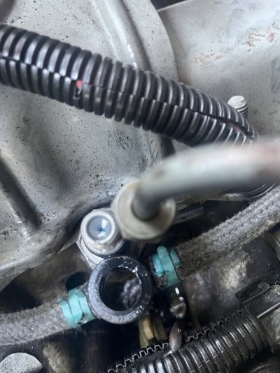

Ok so the suspected injector (#3) i popped the hard line off and I found excess superlube here! Hopefully this is the issue

swapped obviously problematic #3 with #2 and now the knock is almost gone still faintly there but a noticeable improvement, i wonder if i did something wrong on install? I've done 2 sets of injectors prior to this no issues so maybe rushed? anyways im going to fill the filter up with atf and run her hard then fill it with atf again and let it sit overnight
