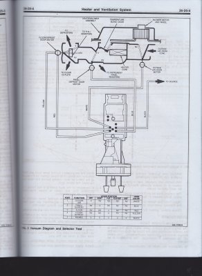

Greg, here an 89 vac circuit, yours can't be to much different.

thank you that is very good! SO it looks like I need to get the left most motor (floor/def otor) to stay in the middle position. Is this motor located behind the radio/ in the middle of the dash?
Outside air motor/white line is inside the engine bay. I have that one manually set to recirculate cabin air.
Panel/defrost motor is default set to defrost aka blocking air from coming out the face vents.
so yellow line is what i need, and somhow keep the door in the middle.
What does V and NV stand for?

I would think V= Vacuum---NV= No Vacuum. Don't know where the motor is, never had to mess with the system.

hmm, so the motor in question, has PV..partial vacuum on it to hold it in teh middle position? lol shiet what is partial vacuum?!
