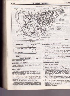

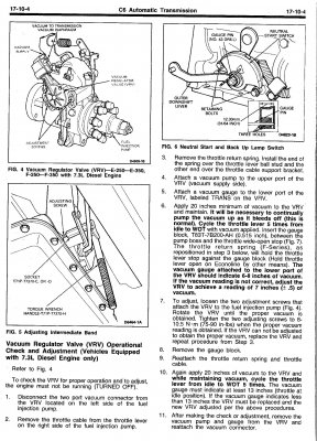

Check the linkage to the C6, make sure it's in the detent in reverse, with engine OFF, Key ON, shift into reverse, crawl under and see if the shift lever will go any further into reverse.
342
Adjusting the neutral and reverse switches.

You should have 4 wires going to the neutral safety switch. Two of them will be the same color, red with a blue stripe. This is the neutral safety part of the switch, leave those alone.
The other two are the reverse lights. One is the power feed coming in, the other is the feed going out to the reverse bulbs in the rear.
As was mentioned, check for power on these other wires. I want to say the wire going to the rear is black/pink but I am not sure about that. If you unplug the neutral safety switch wiring plug, you should be able to jumper these other two wires and make the reverse lights come on if the key is in run.
