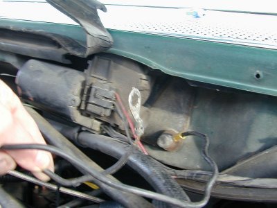

While trying to diagnose an inoperative windshield washer pump, I noticed this18 inch long ground wire attached to the windshield wiper motor bracket.
Where does this unattached wire's other end connect to?
My truck is an '88 Ford F250 7.3L Diesel 4x4 with airconditioning and C7 tranny.

I have an 87, no air and manual transimission, but I will go see if I have a wire like that. I would guess it to go to one of the intake manifold bolts, most likely the same one your glow plug controller hooks to, but I look at mine.
On edit - Mine does have it, it goes down and hooks to one of the upper bell housing bolts. Has anyone had the transmission out of your truck? I would guess they forgot to hook it up. I would also not hesitate to hook it to the stud on the intake that also has the solid state gp controller hooked to it. I would also run another ground from the frame over to the motor as well. I ran one on each side front to the frame, then on the d-side, I ran a 10 ga wire up to the stud on the intake that I have mentioned. These trucks have terrible grounds and anything you can do will help. You may find that some of your wiper problems are ground related but you stated inoperative pump, which generally is a failed pump. I would check for volatage at the pump with someone holding the button in, if you have power, you need a new pump, if not, you may have a bad switch or possibly ground problems.

That wire is the body to motor ground. On my 89 it is bolted to the intake manifold bolts where the Banks sidewinder air filter bracket attaches on the manifold. Just bolt it up somewhere on the intake thats easy to get to. Do not bolt it up to the exhaust manifold!!! I know of a Dodge owner that kept ruining batteries till someone took a look at it. Seems he had replaced the battery ground but bought one just a little too short so he used it on an exhaust manifold bolt. It grounded fine but... Copper sure transfers heat and his batteries kept burning up because of all the heat they got from the cable. Tis ok... It WAS a Dodge and an old 360 at that.....:rotflmao

Thanks for the replies everyone. I'll go ahead and secure the ring connector to an engine lifting eye bolt then. ;Sweet .
I fixed the inoperative windshield fluid pump. ;Sweet Problem was due to one of the two wires going to the pump connector being broken and obscured within the harness bundle.
